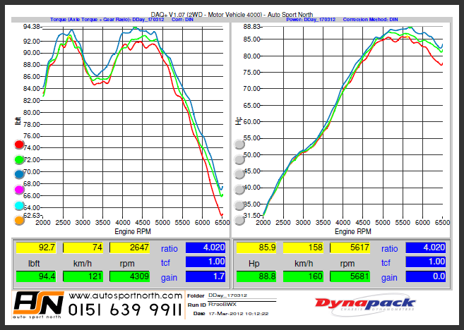

I had a 218 non-VVC Bubble that I fitted a 52mm TB to along with a cold air fed induction kit and a back box,
at a DYNO session it put out 120BHP which is stock power, still a good figure.

Interesting. Do you still have the dyno graph ?
I've always used the standard rubber air feeds and airbox in which I tried drilling a couple of small forward facing holes which gave me no further improvement.
I wonder if the throtle body gives more power before reaching peak power which comparative dyno charts might show.

#13 Post by ROVER-25X » Sun Jan 06, 2019 8:51 pm
It was 7 years ago but you are in luck.
120.1 BHP at the flywheel, 88.8 at the wheels.
