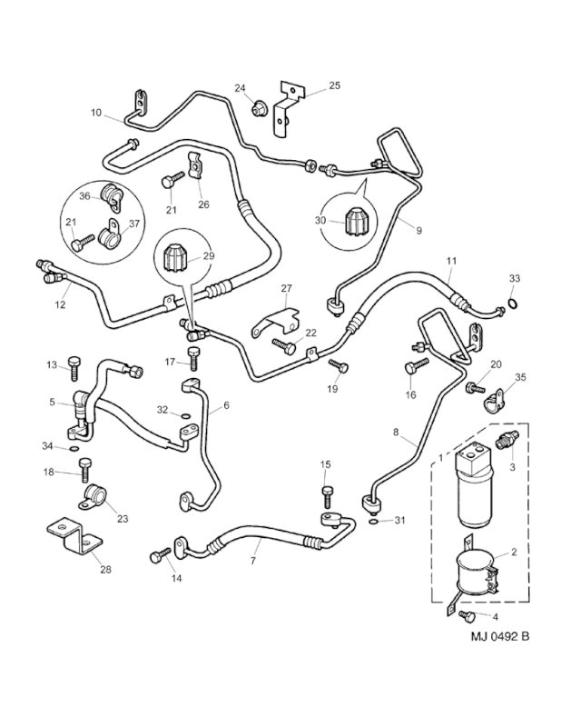

Have a look at Rimmer Bros diagrams to see what part numbers you can find and i may be able to fill in some gaps.

Unfortunately rimmer diagrams are not so accurate, in terms of differences between 1.6L and 2.0L versions, because they don't list the details for parts NLA (which is the case for most of them).
So, there are parts I don't know if they are different or not. Of course the pipes inside engine bay will be different, but I've gathered everything.
Now my only concern is about the items that should sit near the firewall/under the dashboard. As I can see, our car uses a radiator/evaporator, and that's the one I'm not sure if different or not, and where it should be installed.

I'm currently trying to source aircon parts for my FDH which had everything air con removed from the engine bay after an engine swap.
I am getting absolutley nowhere with getting any of the engine bay aircon pipes so if you come across any duplicates let me know.
My first bit of advice is look on allbrit.de it has all the diagrams and part numbers you will need.

This is very short-sighted of them, they used to be comprehensive listings. Has all the hallmarks of recruiting a 'new broom' who causes havoc then moves on.
If it helped someone track down NLA parts or equivalents elsewhere, instead of scrapping their vehicle, they'd retain a future customer for what they do have in stock.

I have compared the evaporator diagrams on rimmers, the R8 part is a lot different to the later R3 one. The post 95 cars have the R3 dashboard and heater ducting. There is a chance the evaporator will fit if the bulkhead is the same. R.E wiring; I think the electrics were a comination of R8 & R3, so a wiring diagram for these cars might be a starting point. I have the 1999 R3 200 diagrams, The 2003 25 diagrams, but i only have have the 1992 R8 diagrams (pre 5AS imobilliser) are these any use to you?

If you can't get original parts, you may be able to make use of some generic/universal parts. A useful company for DIY car stuff is Car Builder Solutions, who are aimed at the kit car market, but have a million and one of those "If only I could get a......" type parts. Their online catalogue is pretty good.
You should be able to make up pipes etc from universal parts and I can guarantee that there is info on the WWW that will give guidance on retrofitting aircon.
A guy called Brian Gunn retrofitted climate control to a Rover (possibly an R8) - might be worth a search for his writeup. I think it was on ARonline
L series diesel parts sound like a good starting point, though.

Re: Coupe air con - help please
For compatible parts go on to Rimmer Bros and compare the K-Series, T-Series and L-Series engine A/C pipes
and parts to if you get matching numbers for a K or and L, remember, the 400/45/ZS is an option to look at too
as I found matching part numbers across not just engines but car models too, here's some of my info.
All parts from the 25/ZR fit.
Condensor - 45/ZS will fit.
Compressor - 45/ZS will fit.
Compressor Bracket - 45/ZS will fit.
Condeser Bracket RH Upper - Part No.: JRF100340
Condeser Bracket LH Upper - Part No.: JRF100350
R8 A/C Switch - YUG10029
