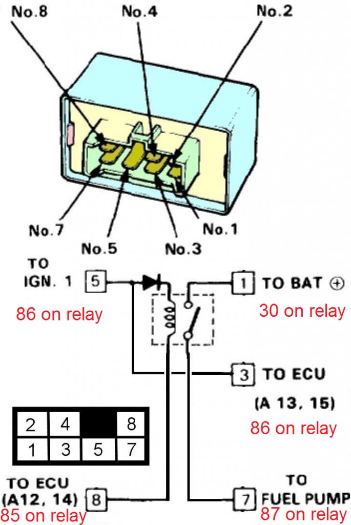

One of my favourite fixes! You can completely solve this issue with a cheap, regular relay and dump the weirdo Honda relay in the bin forever . This diagram pretty much explains all you need to do... I can even put a 'how-to' together when I get a spare minute... I'll get round to joining the club too!GTiJohn wrote: 2) Honda 1.6 fuel relay causing engine stalls. Normal solution is just to replace the relay with another one an hope! Alternative relays have been suggested but where is that info? Link?

Yes please.pete2783 wrote:This diagram pretty much explains all you need to do... I can even put a 'how-to' together when I get a spare minute... I'll get round to joining the club too!
To both !
