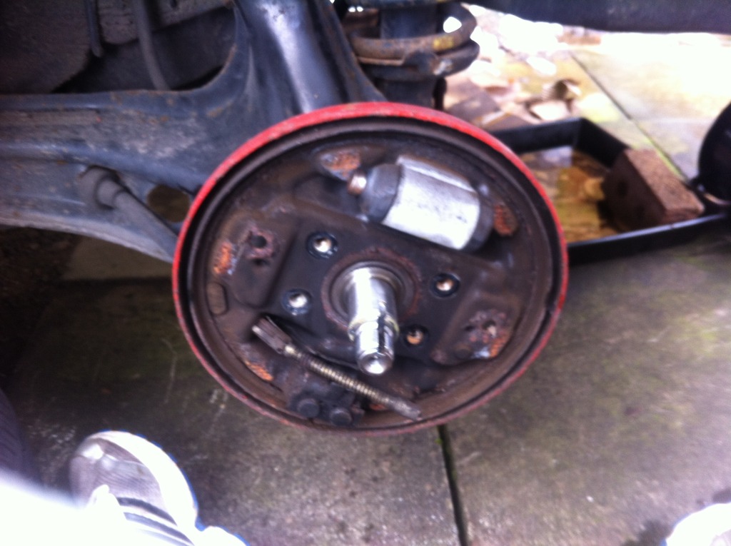

#13 Post by RoverRevival » Thu Feb 08, 2018 9:34 pm
basically this
The drip tray was oil, coolant and brake fluid mixed.....yummy

#14 Post by RoverRevival » Thu Feb 08, 2018 9:35 pm
you can also see in the last pic that there are no holes for the calipers to attach
