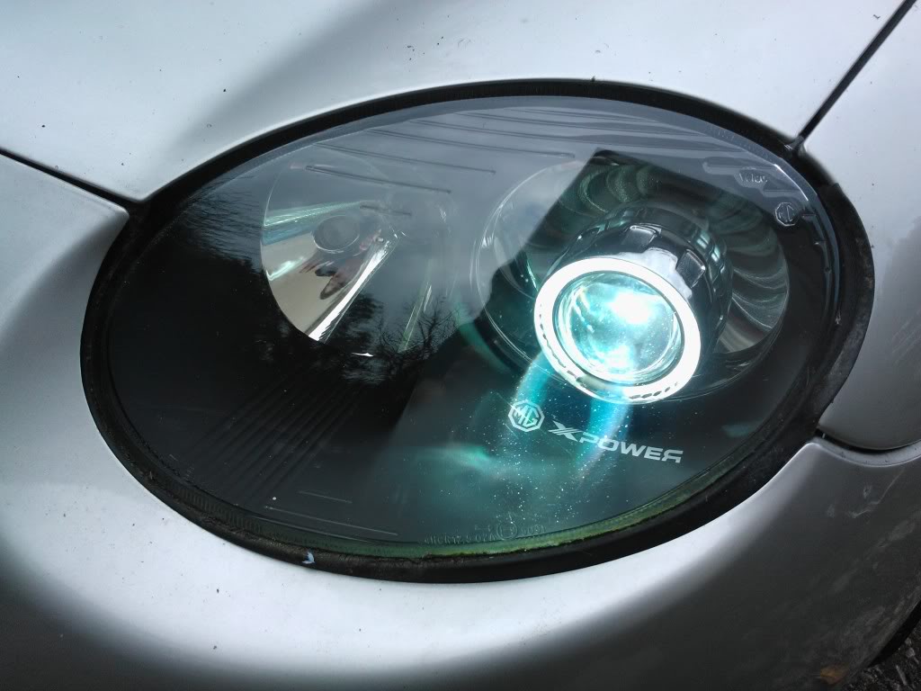

I though I might attempt to fit one of these kits too, yeah the beam refractors on the glass may be

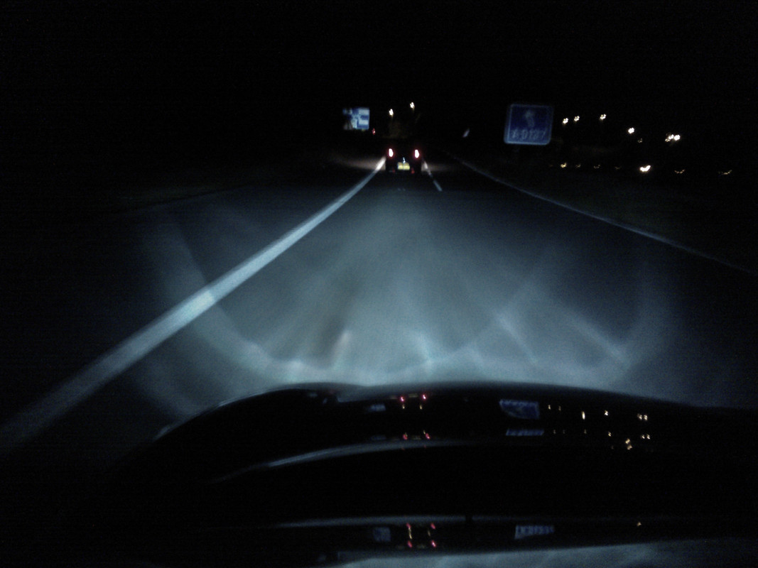

an issue but at least its worth a punt, at least they wont blind oncoming drivers like most HID kits

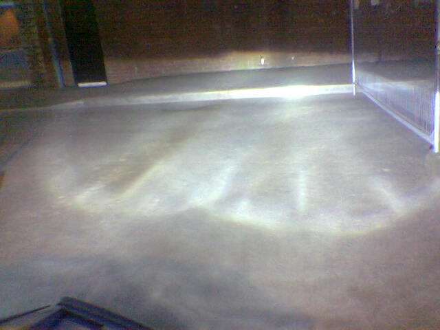

do, this is the beam pattern on my MGF projector headlights.

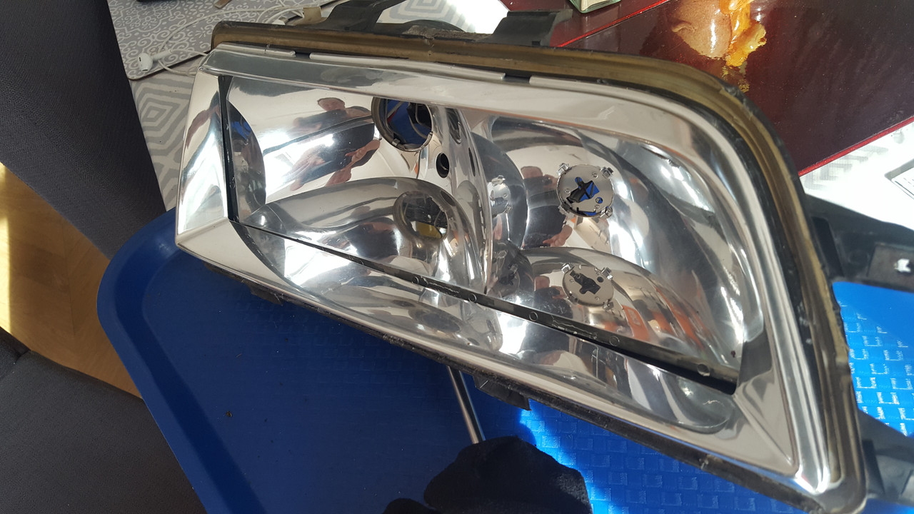

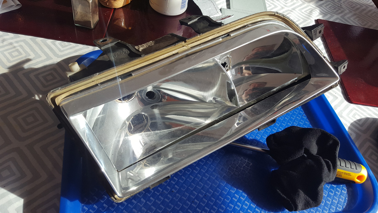

So far I have started stripping one spare headlight 1234dist kindly donated to the cause.

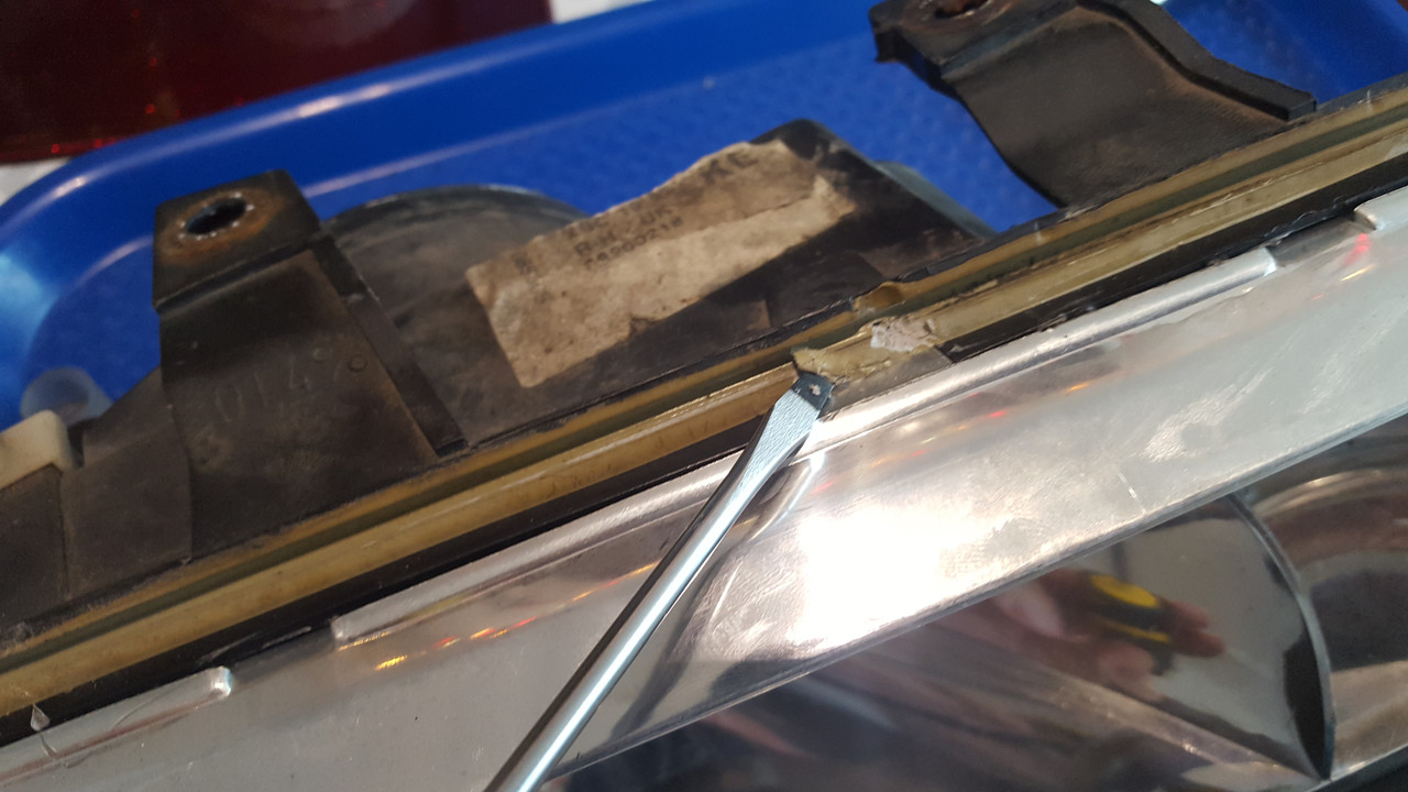

I baked it in a preheated 140'c oven for 5 mins to soften the adhesive, then I gently prised the glass
lens off, be careful not to force it as it can sent glass chips off at you, slow and steady.
Once off you can see the light is comprised of a one piece twin reflector unit and a chrome trim piece.

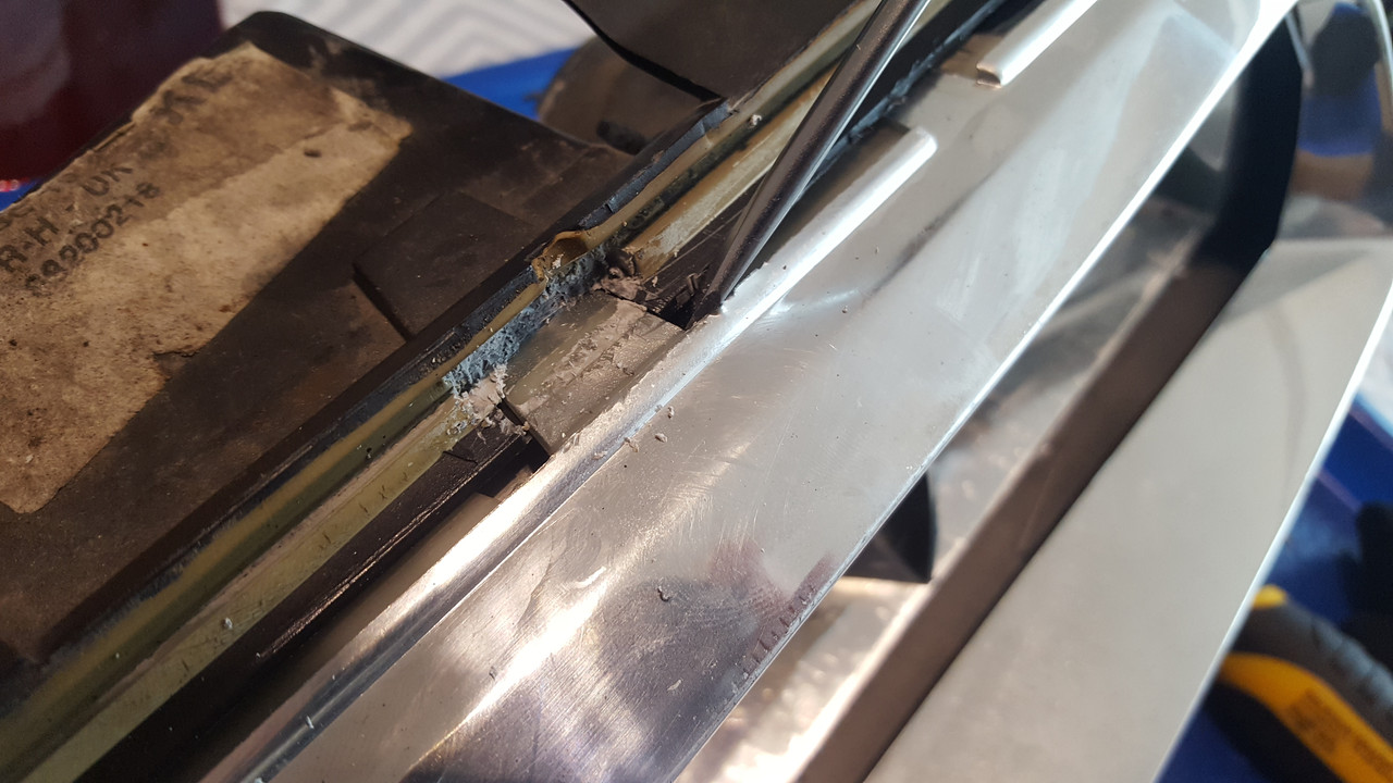

To remove the trim piece is just a matter of freeing 6 clips, 2 of them though, one top and one bottom
are sealed in place with the original glass sealant, using a thin flathead screwdriver you can scrape it out
of the way to free them.

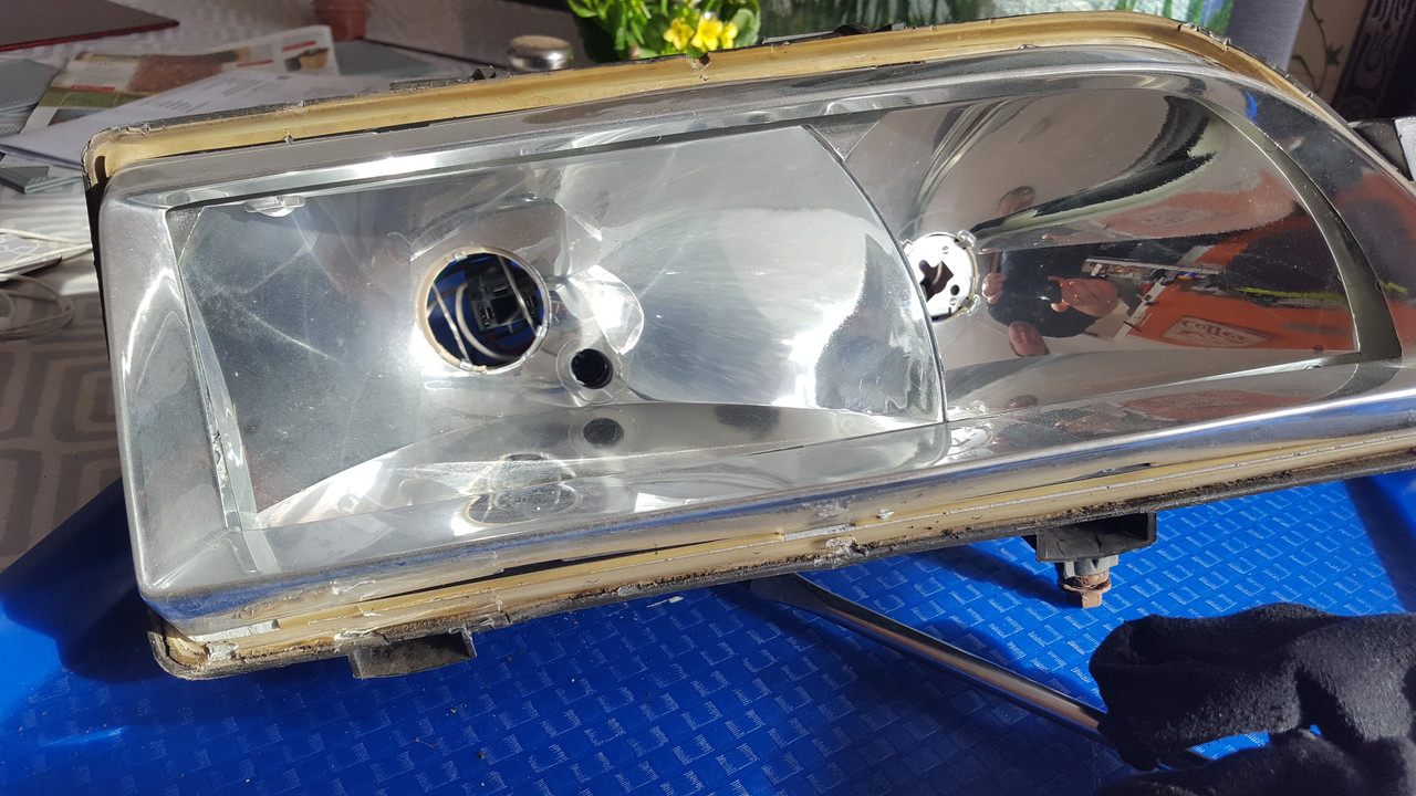

I'm not sure if I should paint the dipped reflector bowel or leave it chrome, as pictured below it is the
dipped bowel that houses the sidelight but I have an alternative LED idea I am pondering or even
relocating the sidelight to the main beam bowel.

I have finished stripping the headlight down, not much to it. :D
Wiring loom removed.
Chrome trim on its own.
The reflector bowel just needed popping off its two balljoint bars, I suspect a clip is missing off this bit though.
Coming apart quite easy so I hope this assists anyone else attempting to strip one down. :clapping

I don't think i'll bother Vinny, as you can see below it isn't required i'd say. Image

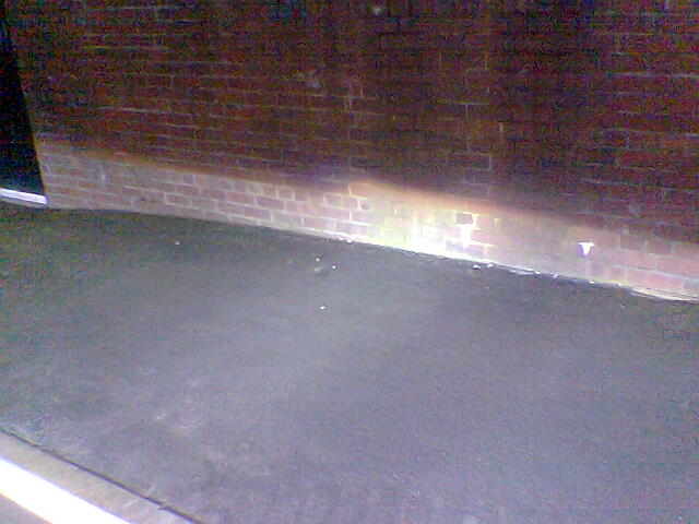

To fit it to your headlight reflector it basically sits in where the H4 bulb goes, it may seem too heavy to be just
supported by the reflector but I have fitted these to several sets of headlights and run them with no issues, just
keep an eye on your beam levels by facing a wall at night.

For now I have placed the glass in place for your viewing pleasure until I get some other bits and bobs sorted, I need to
order some bulbs, only £7 for a pair of 4500k (White) HID bulbs, once they arrive I shall conduct some lighting tests and
see what the beam pattern is like then inform you all with more photos.
