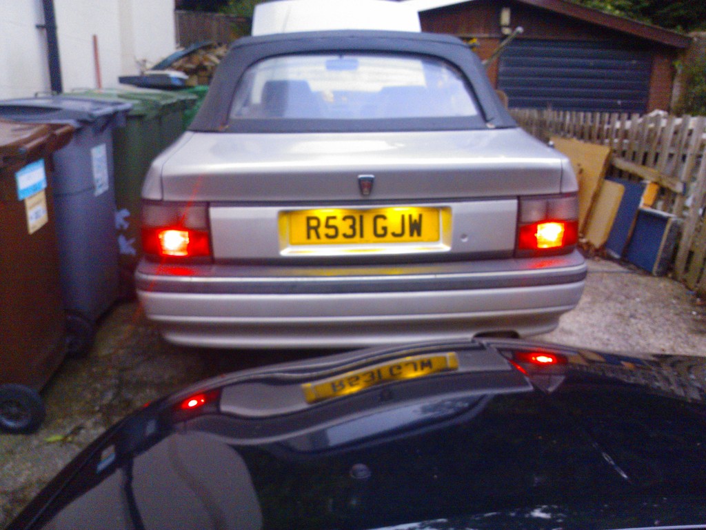

Rear Sidelights: Red 501 9 LED/SMD Bulbs, look great, nice deep red colour, will add brake LED's eventually.

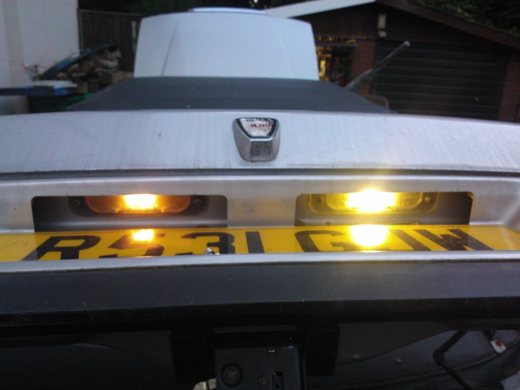

Numberplate: Warm White 9 LED/SMD Festoon Bulbs,

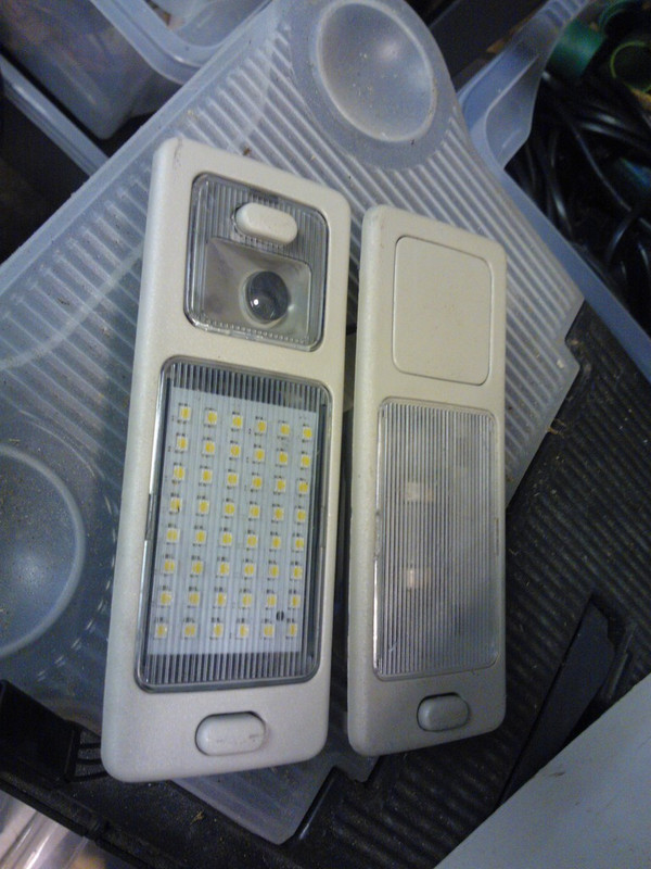

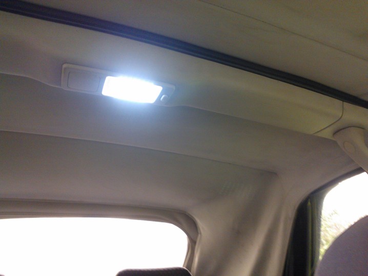

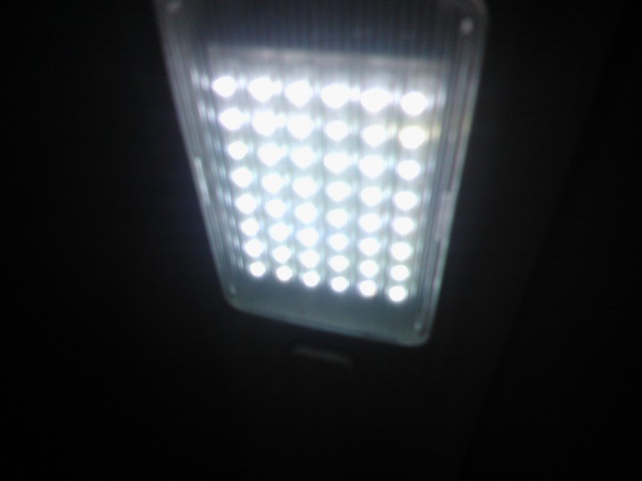

Interior Light: Cool White 48 LED Panel, just an experiment, will swap to warm white eventually.
Can't find a pic of the sidelights but here is the rear lights.
Comparison of a standard bulb and an LED

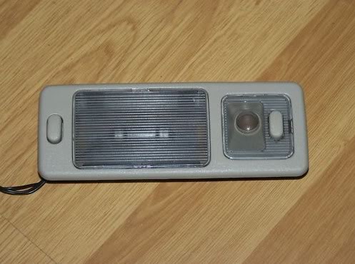

This is my Interior light.
Using this Land Rover unit as an upgrade, still to sort an LED for the map light.
Pics of my old Cabby, it was identical to my current one though.
Old LED lights, same set up but cool white LED number plate lights.

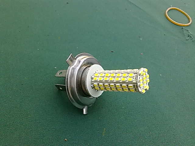

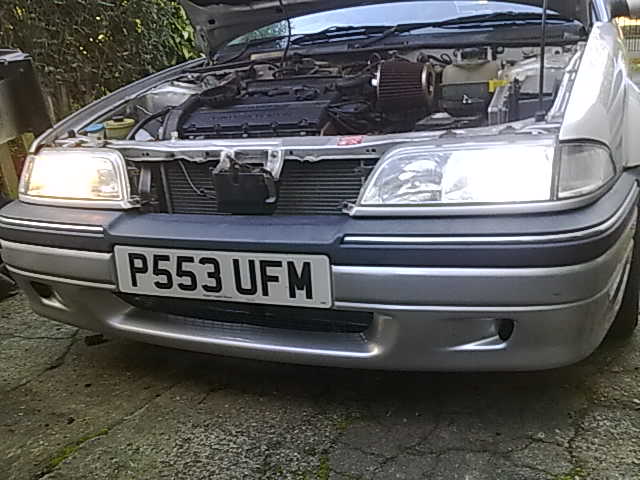

I also dabbled with H4 98 LED Headlights over 8 years ago, just big sidelights, they looked really bright but they did
not light up the road what so ever, Police never pulled me but they were useless and scattered the beam.
Comparison with a standard and then an LED bulb.
