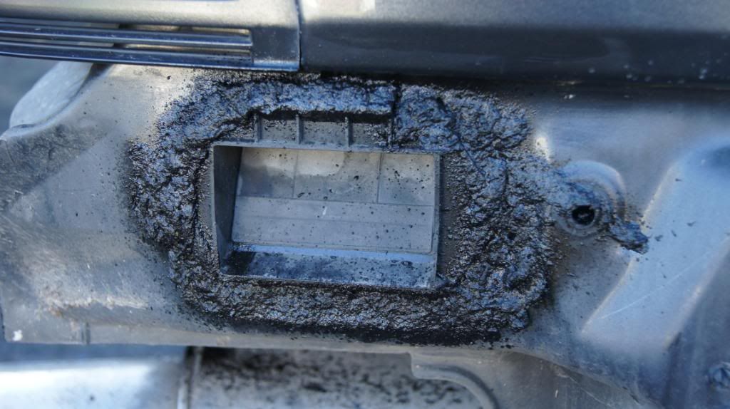

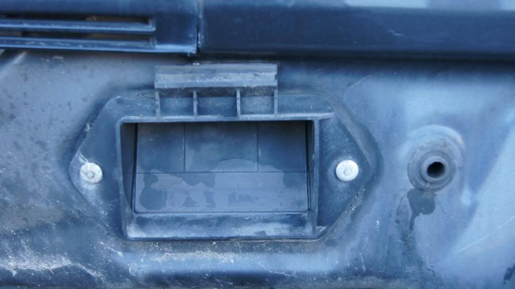

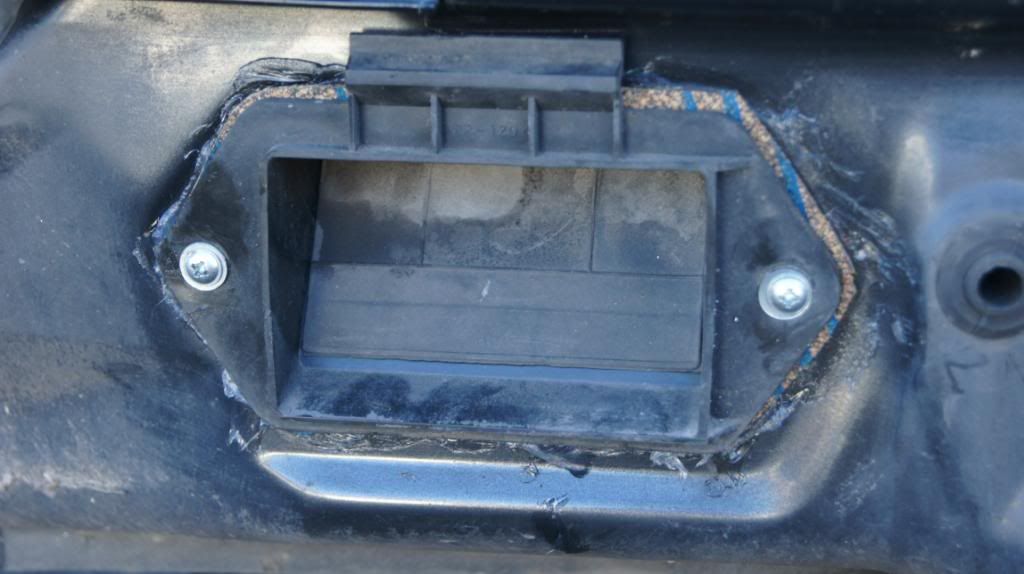

this is going to sound extreme but bare with me.
Take the rear bumper off you see vents on both sides which look like this.
These are also prone to leaking.
Take it out, you will need a punch tool as its rivited and make a new gasket.
Then seal the fap out of it.
Thanks to northener51 for the pics.

There are 3 common ways to get water in the boot.
1. Leaking cluster seals - silicone or new foam gaskets are the usual fix here
2. Leaking vents - it is usually the car to vent seal that leaks so again a new gasket/silicone that is the issue here. The vent flap itself is usually much more reliable. R3's got only one vent whereas the R8 got 2 for some reason.
3. Sunroof drains. If displaced can leak all the sunroof water into the boot instead. Fairly obvious once you remove the boot interior trims and can see them.

I think you just diagnosed where my 414 is letting water in though. Have to get the back bumper off again - which is a good opportunity to sort the saggy bracket I suppose - and get those sealed up properly.
The water is sitting in the corners of the boot as photographed.
The only place I can see it might be getting in is the vents that are hidden by the bumper, you can see in that last picture that there's some water staining from it to the wetness in the boot.
I'd dismissed it being the vents because they looked okay but having seen those pictures above I'm fairly sure that's what's doing it because the water is coming in at boot floor level and soaking across the trim.
