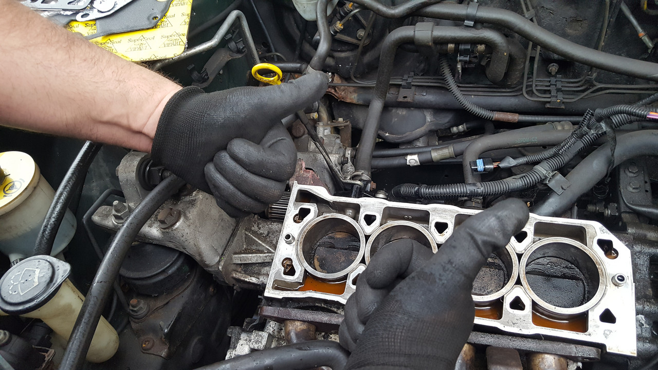

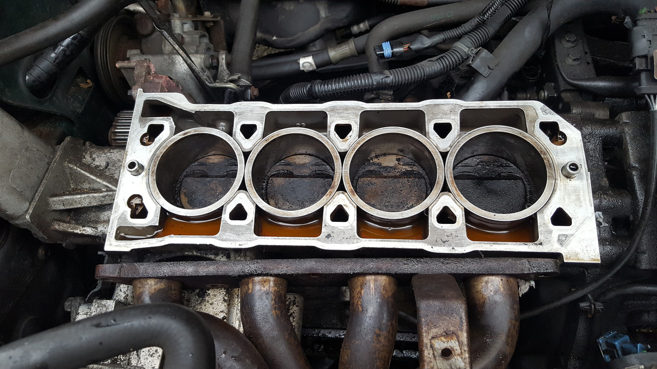

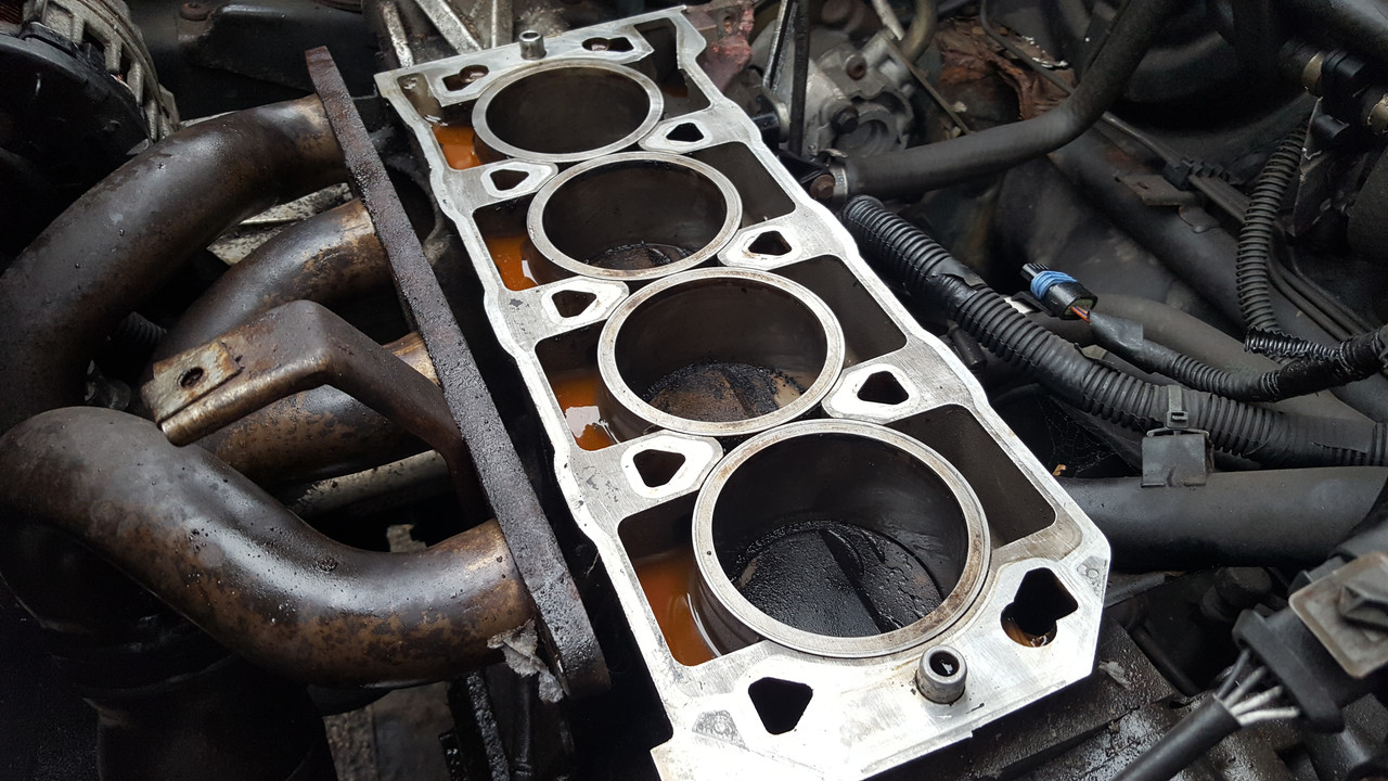

Finished cleaning up the block, the surface was lightly sanded and wiped over with brake cleaner, I also got
any oil contamination out the waterways with a syringe, before we finished last week we sprayed and wiped
WD40 in the bores to prevent rust, it had a bonus effect, it lifted up the heavy carbon deposits off the top of
the pistons, quite happy with how it turned out.

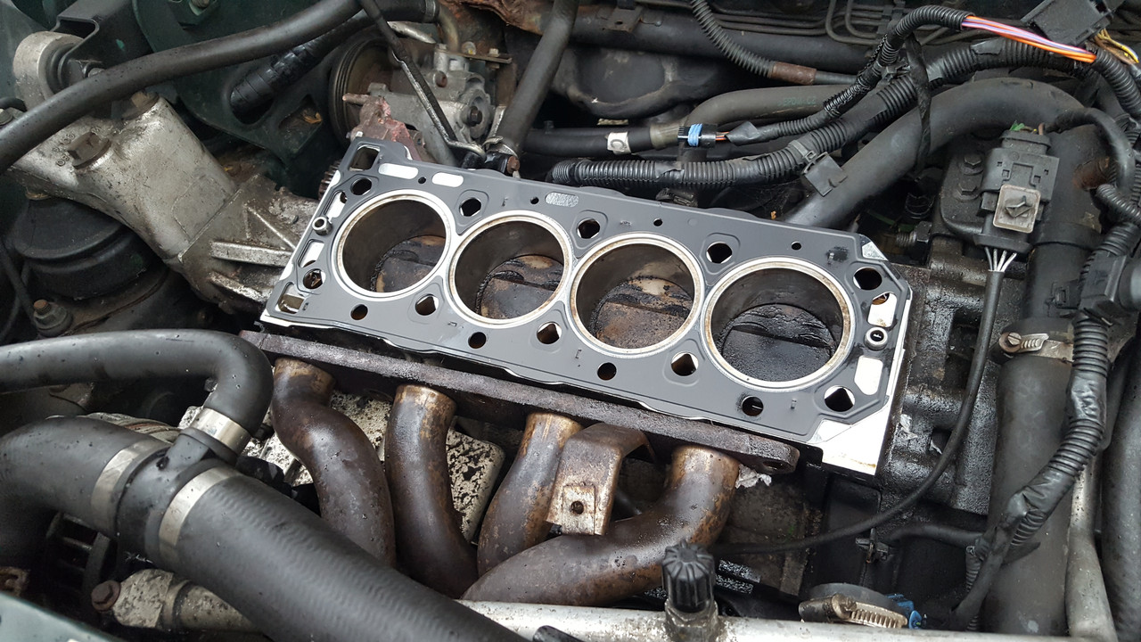

New MLS put in place.

i'm not seeing the shim layer of the gasket there or is it an early pic :S

There seems to be quite a loose definition of 'MLS' in general use. Goes with the times, I suppose, there are no longer any absolute truths.
Detail shots of the construction of some MLS gaskets show more than one steel layer, and often the sandwich is united by eyelet rivets through tabs extending front and rear.
The one in this post matches the BGA one I fitted to my rescue job last autumn. That had a single steel layer, conventional crushable fire rings and a pair of outer moulded
elastomer layers. These were bonded, probably by ultrasonic welding, by pinching them together through small rectangular apertures n the steel layer. These are apparent
in the pics above.
I eventually took the view that this was an upgrade of the elastomer design only, over the older narrow beads of elastomer, and fitted it as the instructions for one of those
in respect of bolt torques. I would suppose this would also mean the restrictions on liner height matching would not apply, though mine was an older closed deck engine where
this concern isn't mentioned. Mine's running OK, after a subsequent thermostat problem was sorted, but hasn't come out of hibernation to be stressed on the road yet.
Now that the engine in the pics is clean, it's possible to see the original gasket was fitted the right way up - the small head coolant holes were on the inlet side like the new one.
Just the angle of the photo. :D
