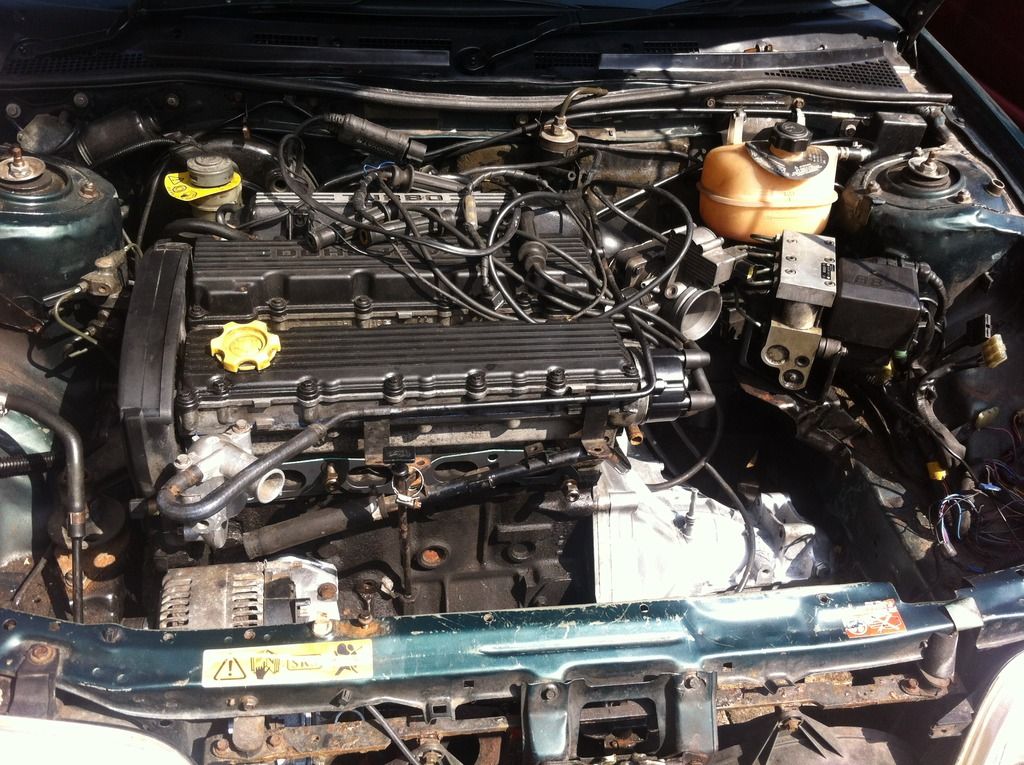

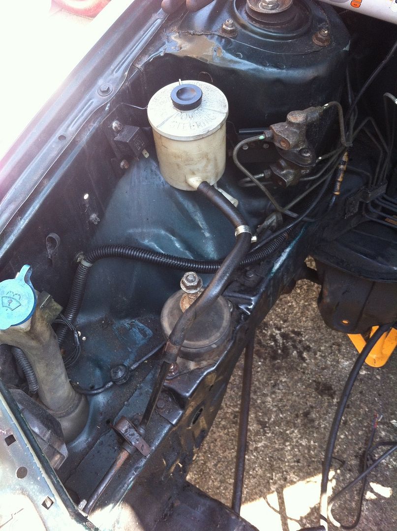

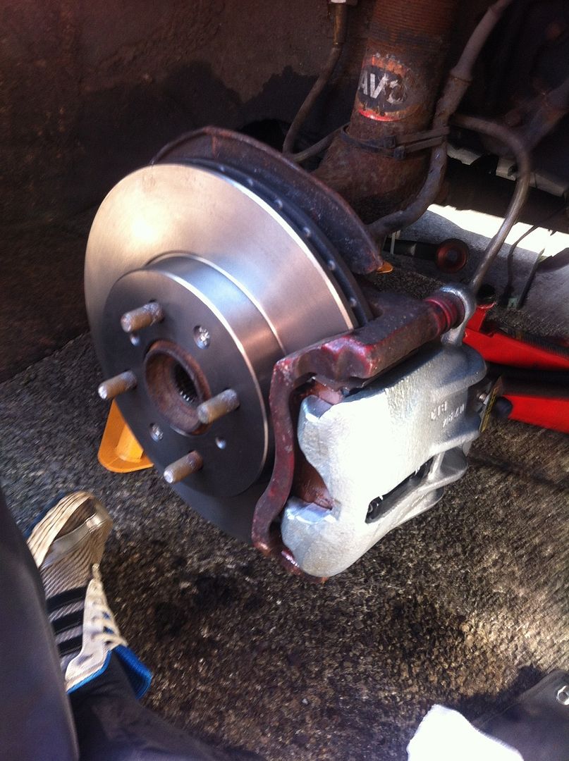

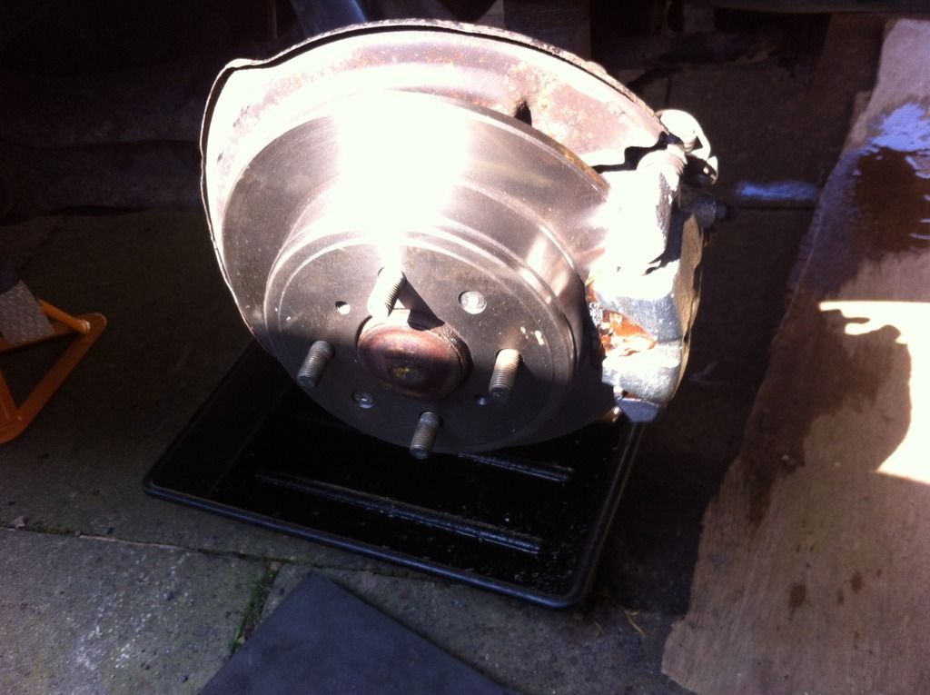

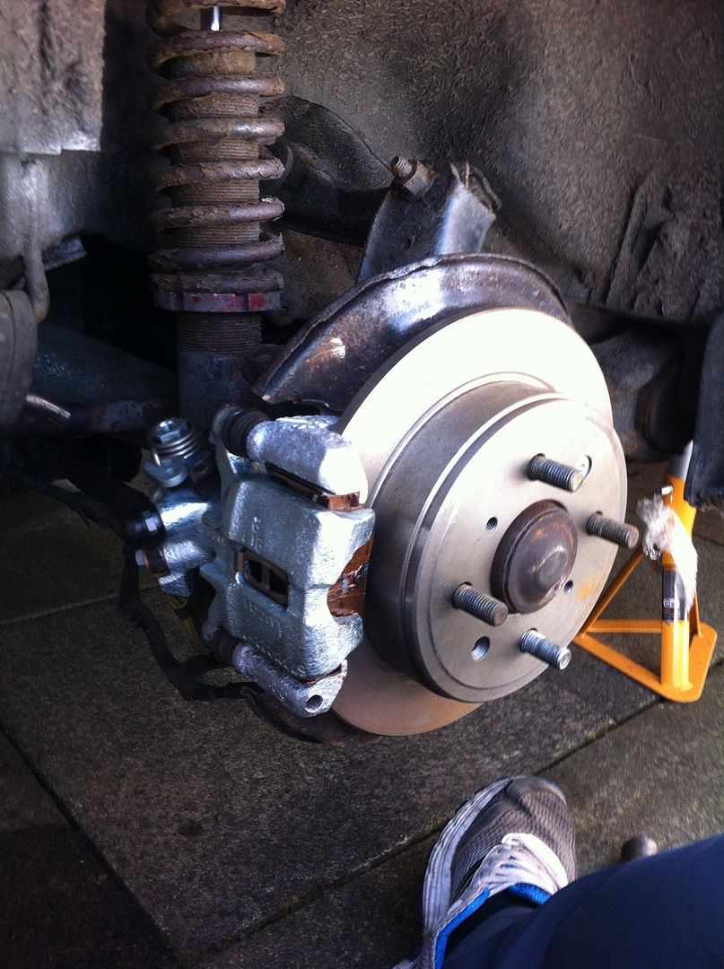

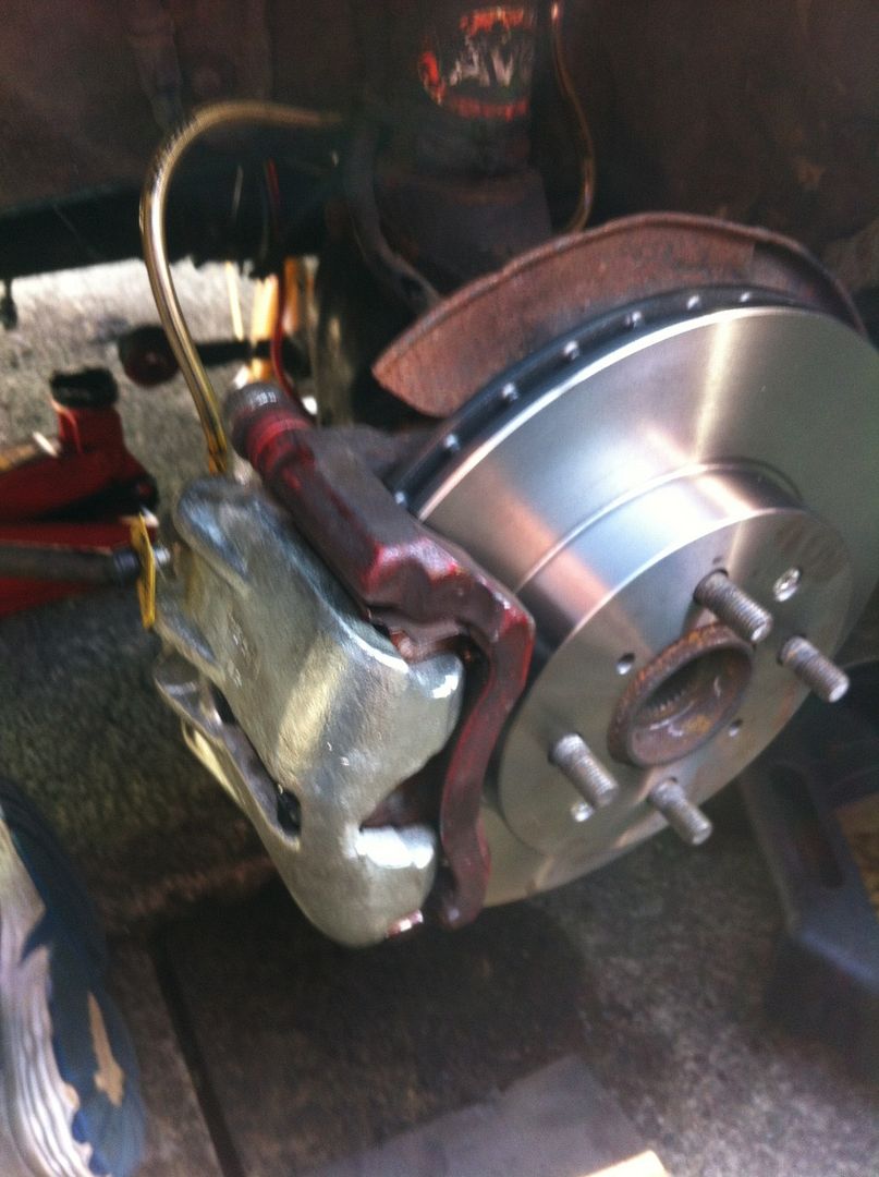

All brakes now complete. Which included drilling and tapping the rear hubs after both sides had previous snapped off bolts in the disc placement screw holes.
All wiring and other nasties that shouldn't be there removed from the engine compartment.
PS bottles fitted.
expansion bottle fitted.

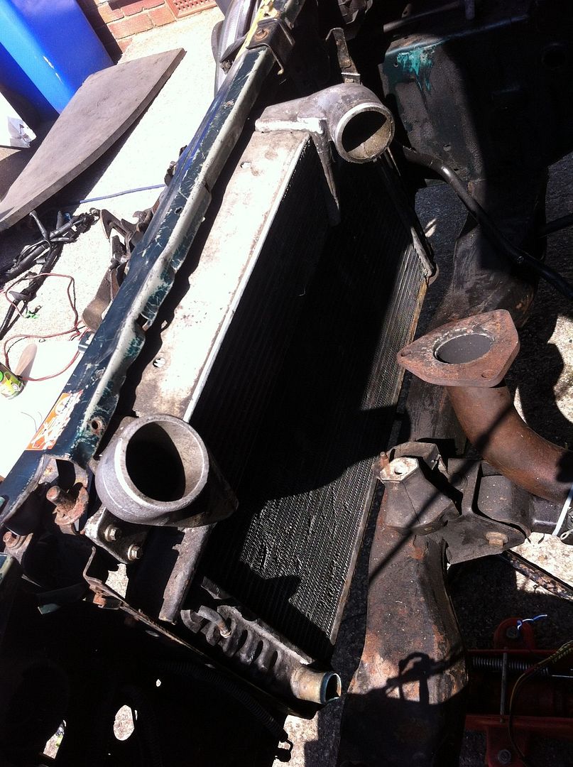

Another manifold swap as well...
Wouldn't mind seeing a picture of what you replace these with, re. coating/refurb etc.

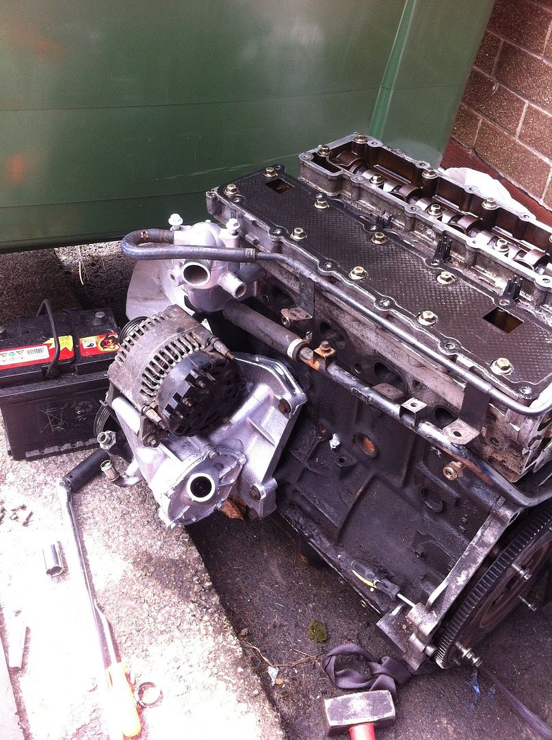

Well update time again.

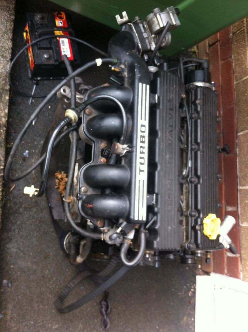

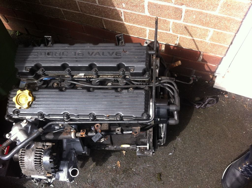

Time to turn my attentions to the mountain of oil in the corner. The engine.
It looked ok, probably could have been dropped in as it was, but you know me. I have to be sure everythings right and a good job i did.
Some of the bolts were only finger tight and others, maining the one that holds the alternator and ps to the block where loose.
Either way, gaskets needed replacing, oil removed and a general spruce up and check of all the components.

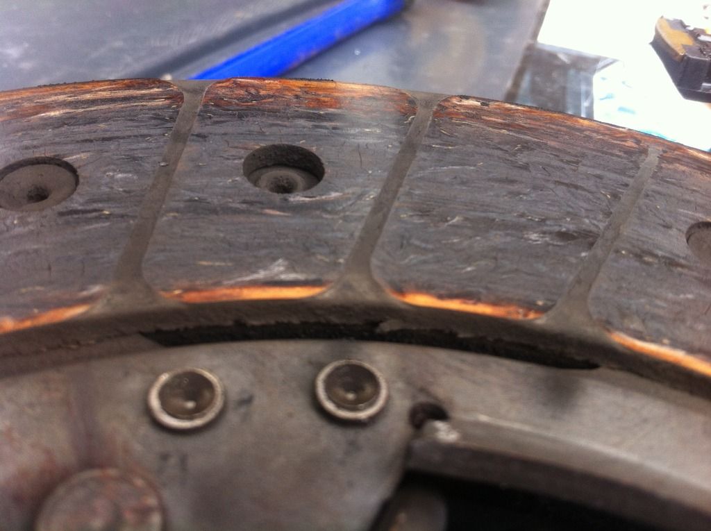

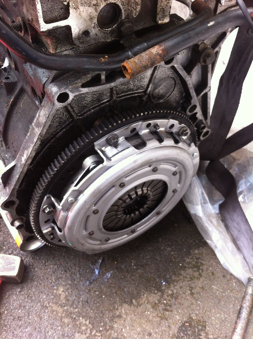

Clutch had seen better days, a long time ago

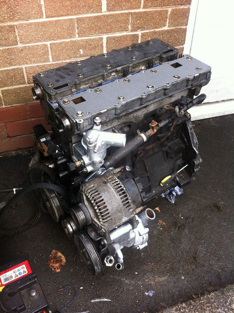

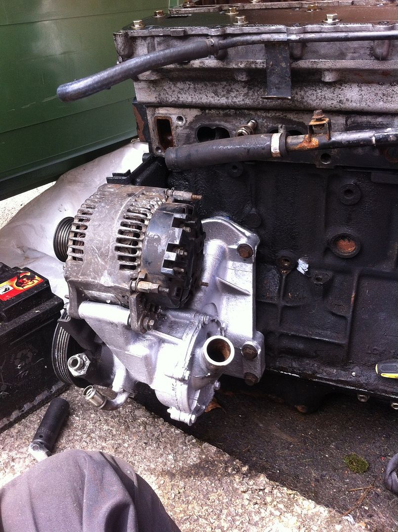

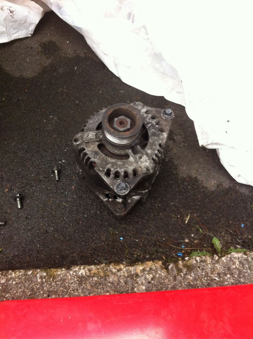

Off with the alternator and ps and water pump housing
mmm not so shiny

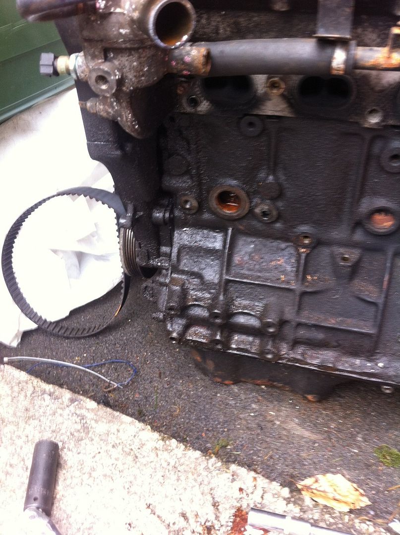

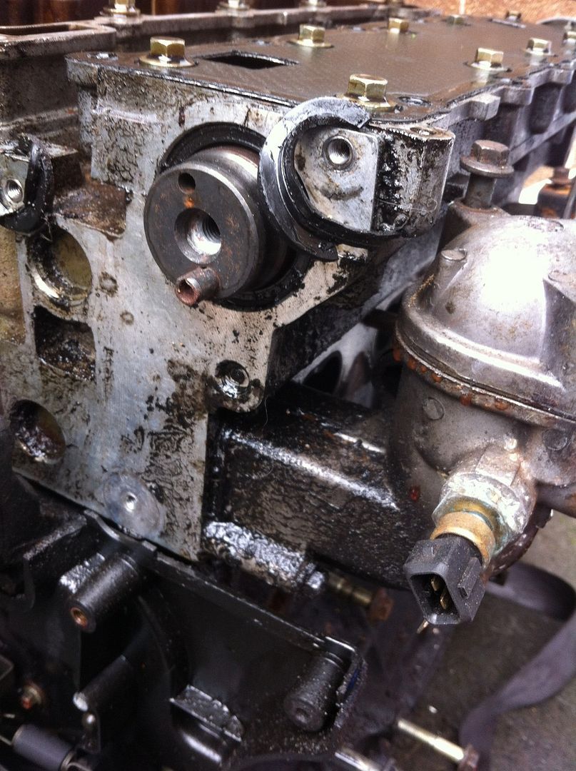

Cam seals look past their best based on the sheer quantity of oil behind the broken cam covers

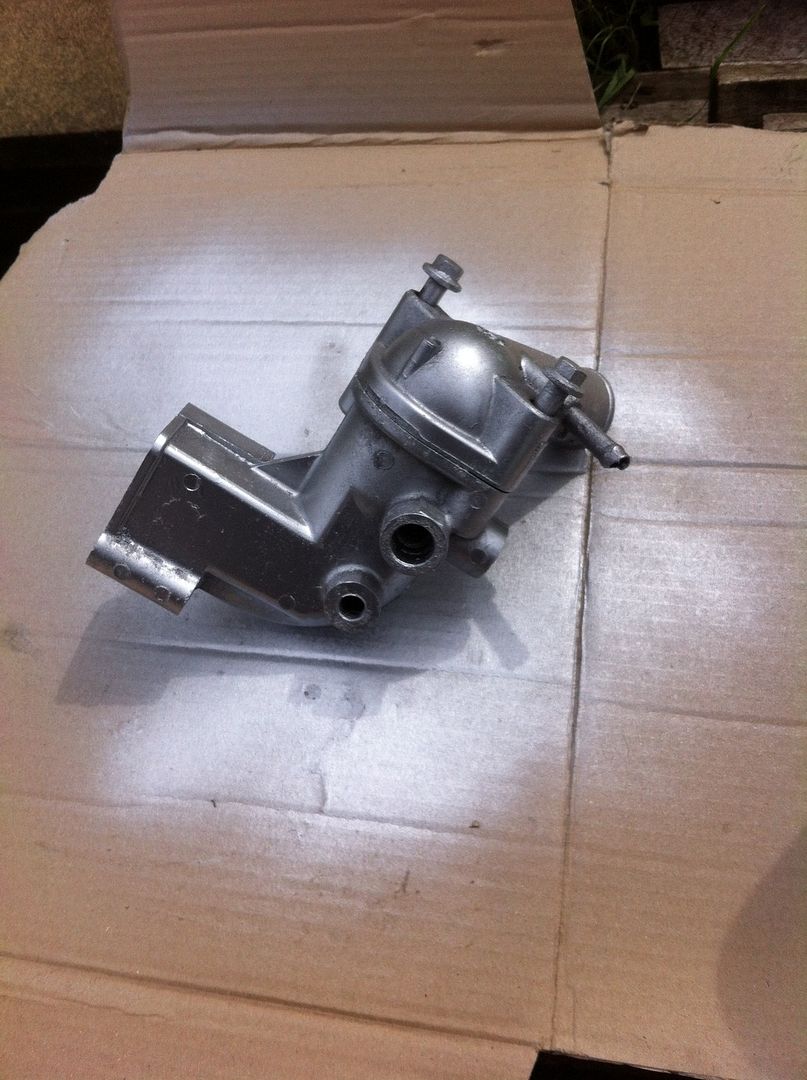

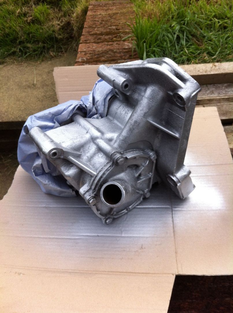

Thermostat housing in primer, ready for silver
same with the water pump housing, old pump still in there for now.

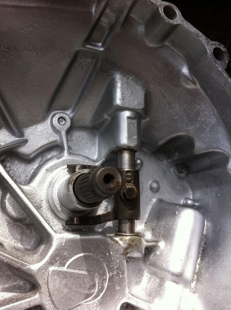

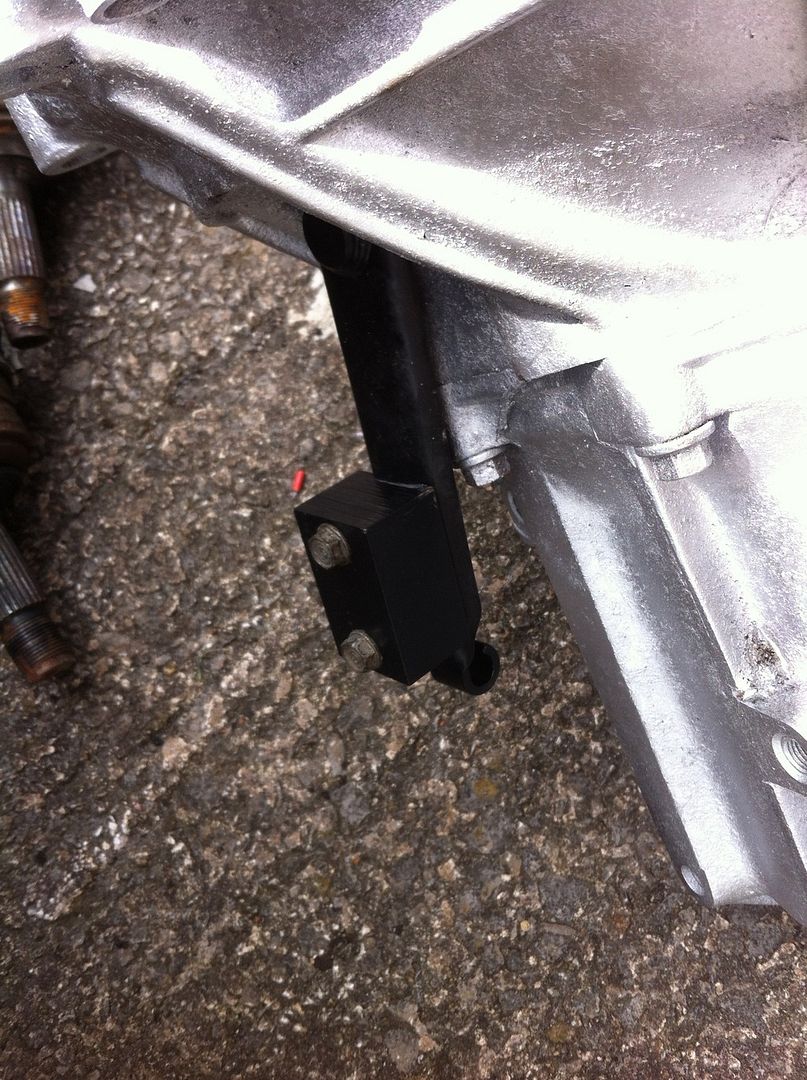

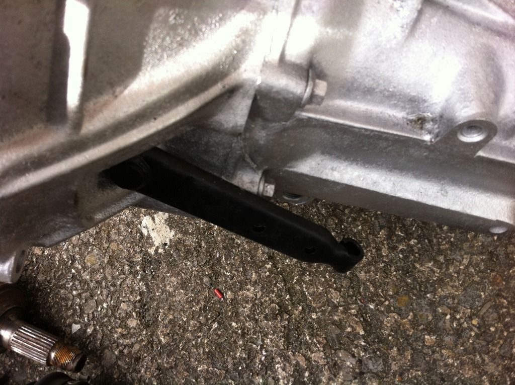

New clutch release arm, counter weight and release bearing claw all greased up, then cleaned off

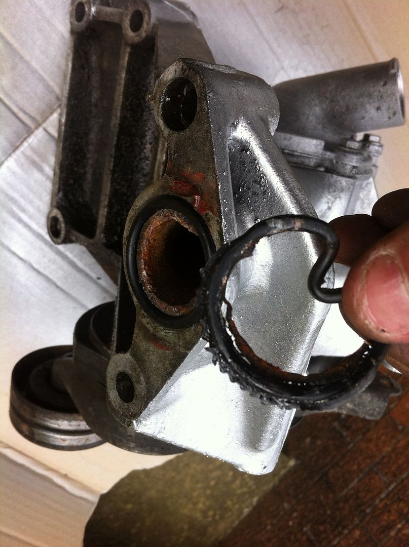

New o-ring fitted to the water pump housing, old one squished.
reassembly begins
Sensors replaced and greased
New clutch fitted
Now we are just waiting on shirly to drop me some new gaskets and i can reassemble and get ready to fit the gearbox to the engine and get it all back in the car.
:cool

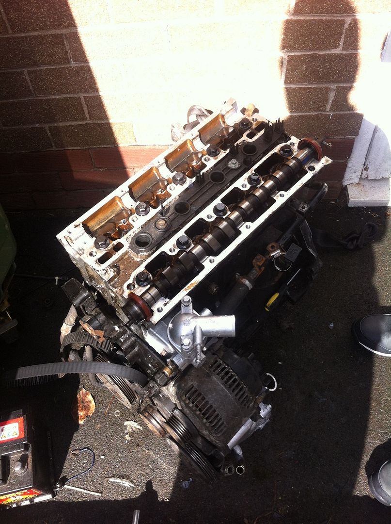

Time to put the engine back together.

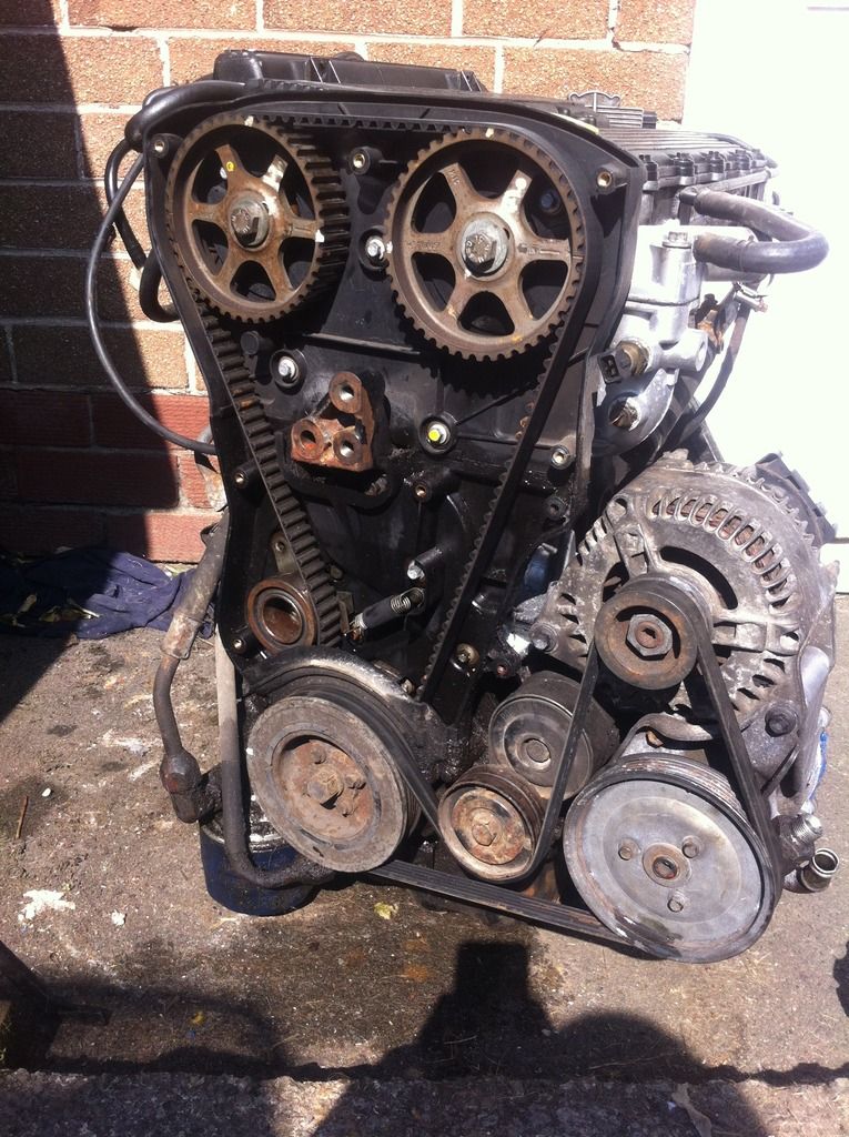

Cams off and new seals fitted
Followed by new cam cover gaskets
Covers fitted, new plugs, cleaned ht Leads, new dizzy cap and rotor arm and both thermostat gaskets and thermostat replaced.

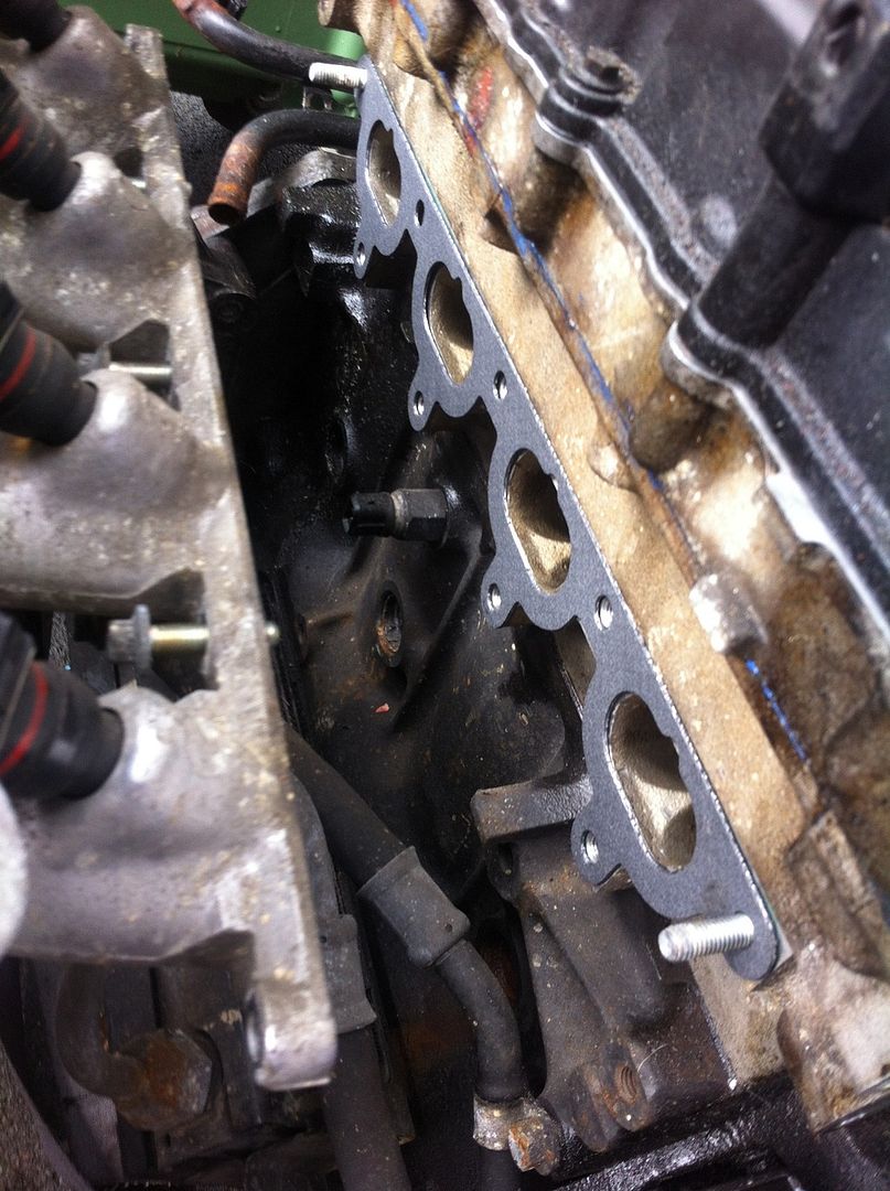

Lower inlet gasket
Upper inlet fitted

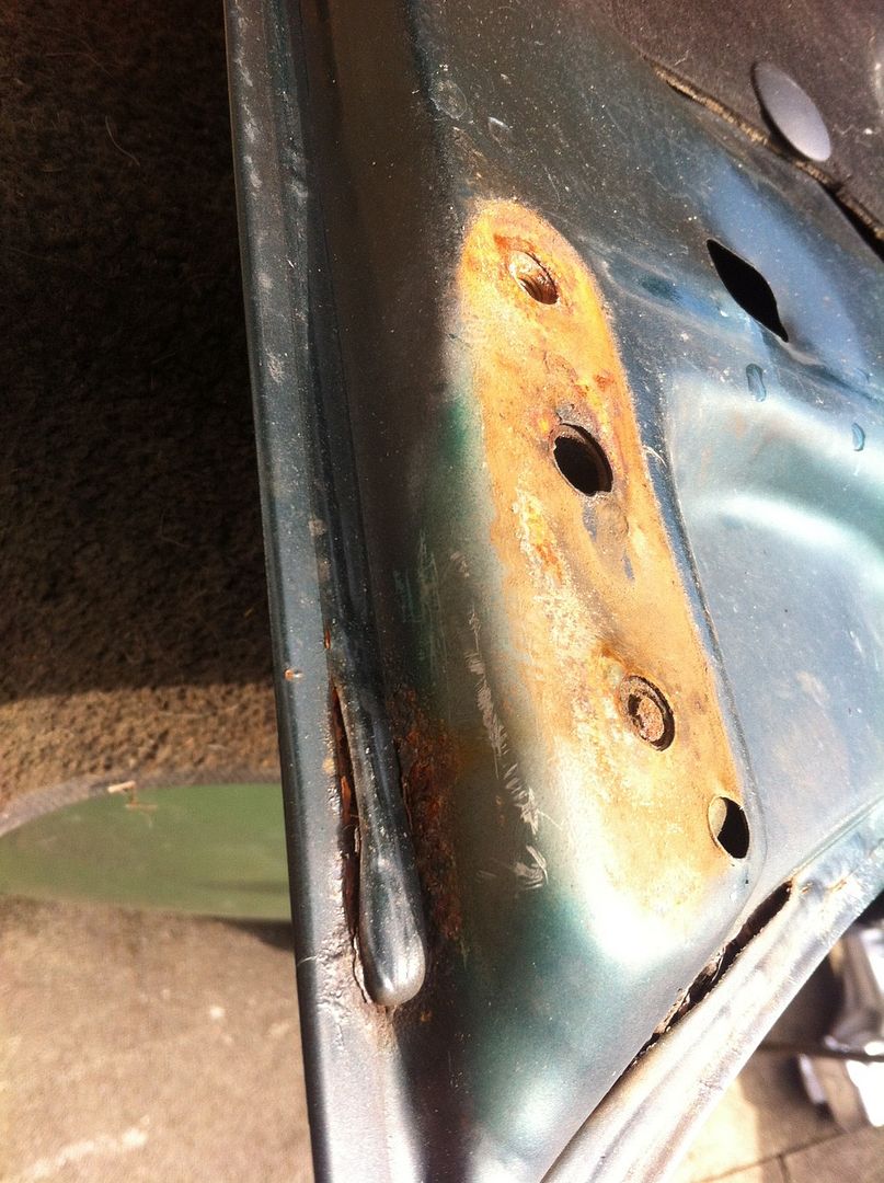

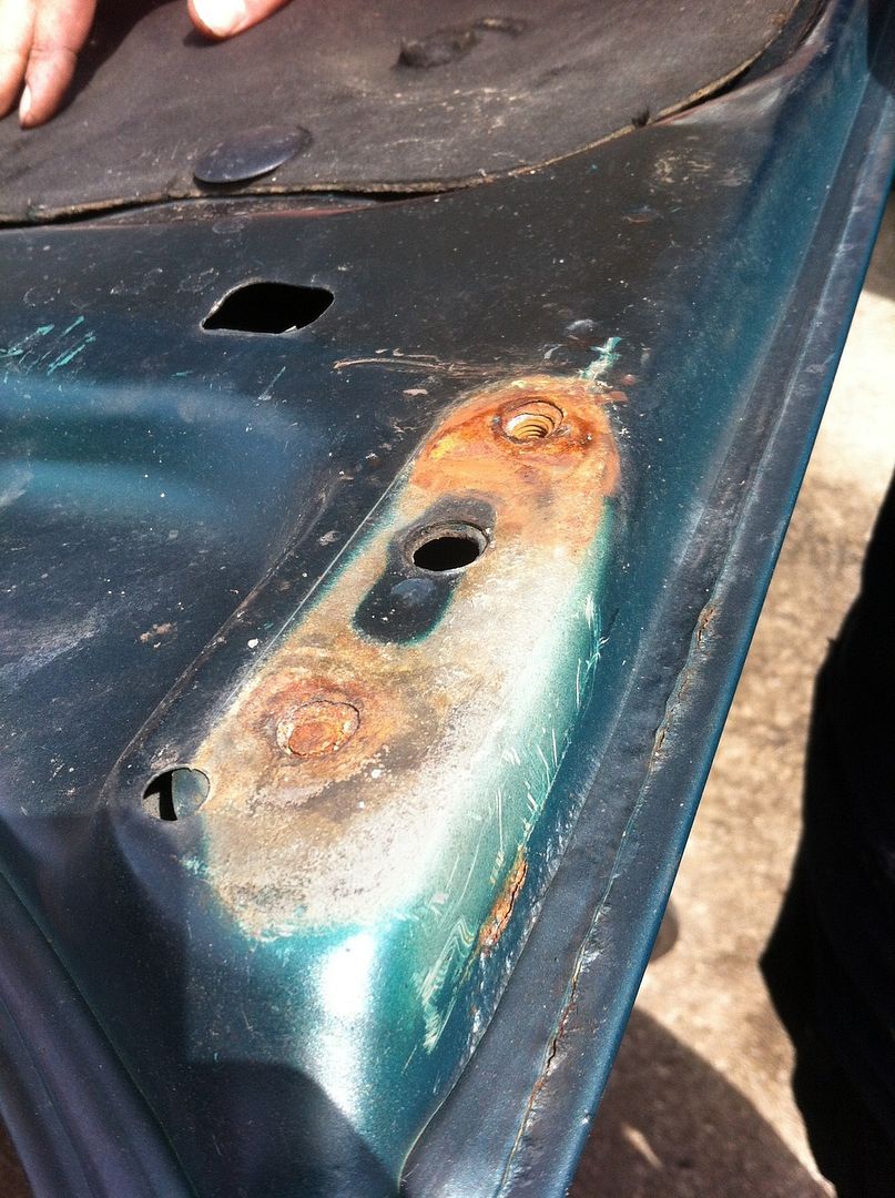

Time to drill and tap the two snapped bolts in the bonnet.

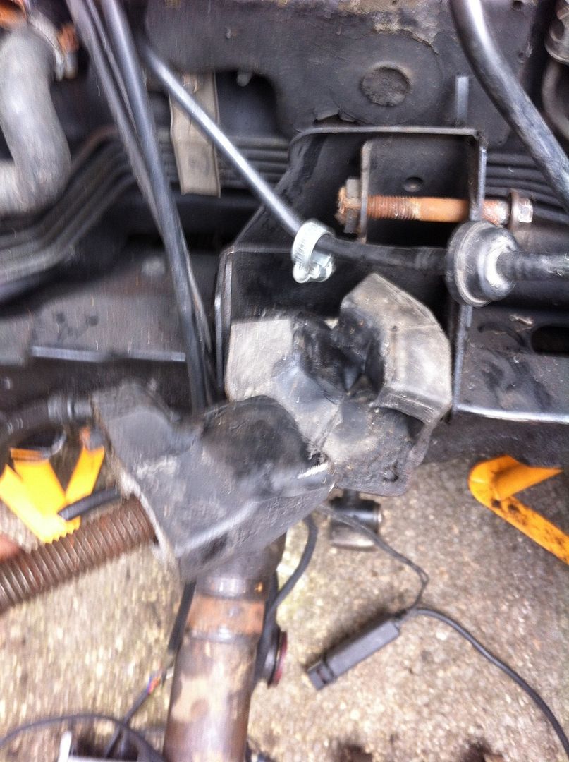

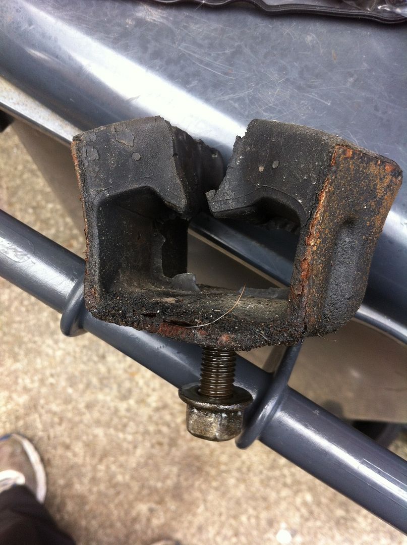

And another nasty surprise, as we were searching the bolt tin for replacement bolts for the mounts, this one came off. and its really smooth meaning its been moving around freely for some time.

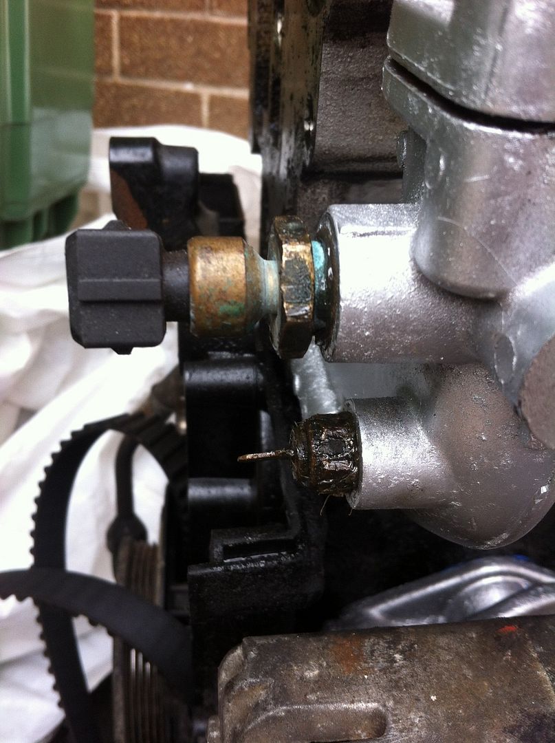

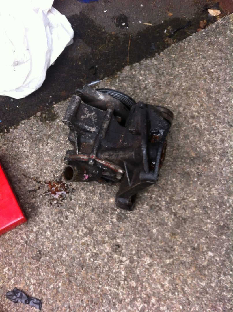

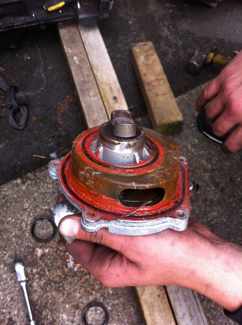

And finally the nasty water pump, will do a completed pic later as the rain has started
Posts: 1357
Re: DCK Project started
#24 Post by ROVER-25X » Sun May 22, 2016 4:10 pm
That pump is as bad as mine ! :blink

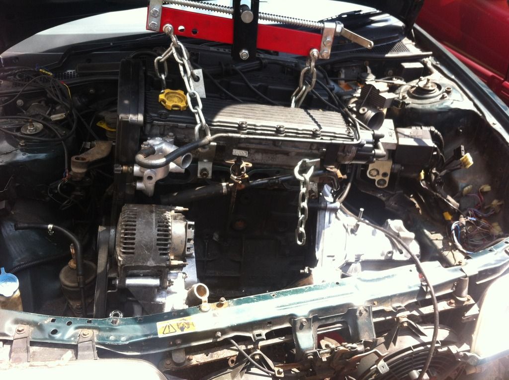

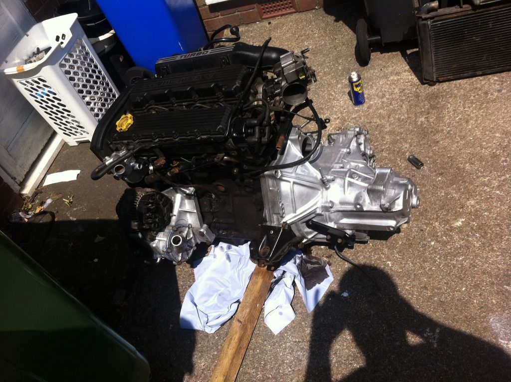

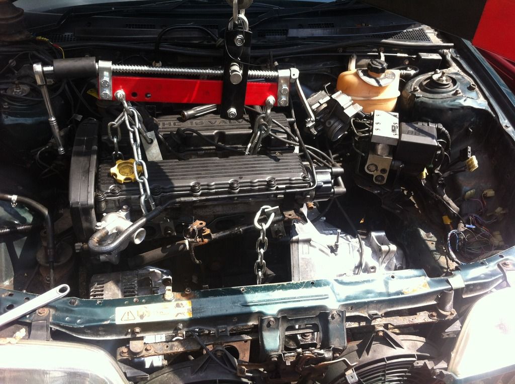

But, progress was required so sun tan cream on and engine off we go with attaching the gearbox and dropping the engine into the engine bay.
Cam covers and mount borrowed from one of my other cars so we could time up and fit the belts.

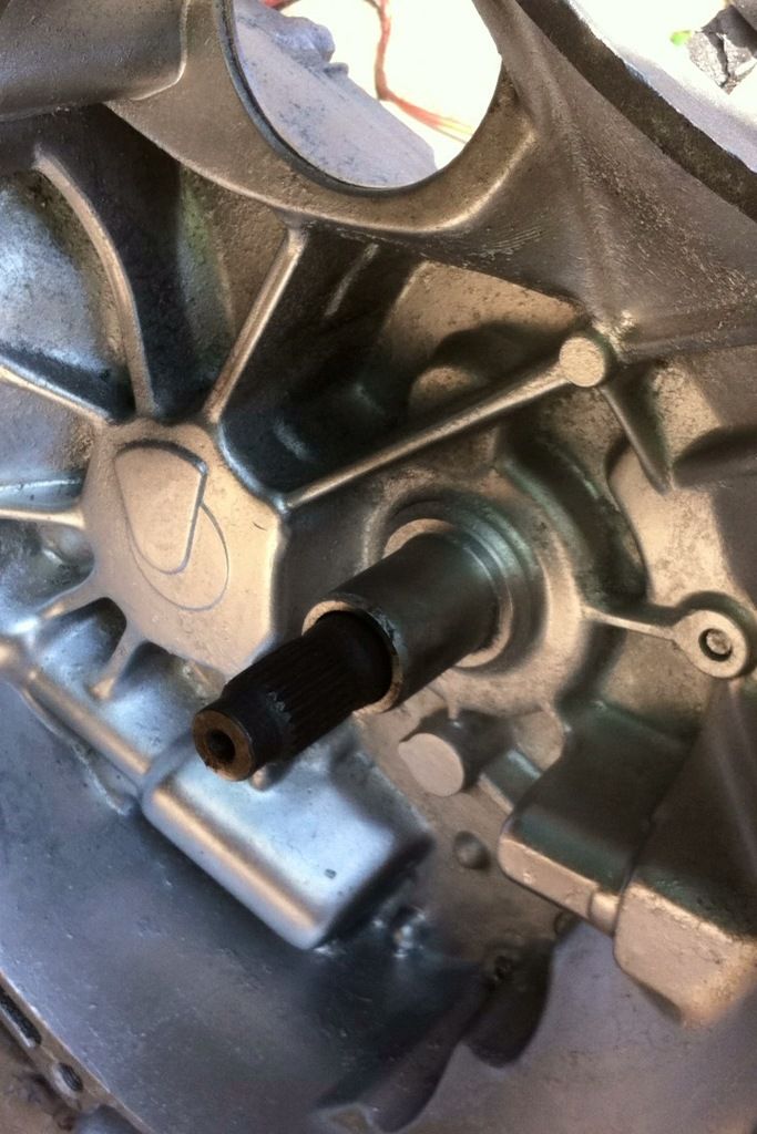

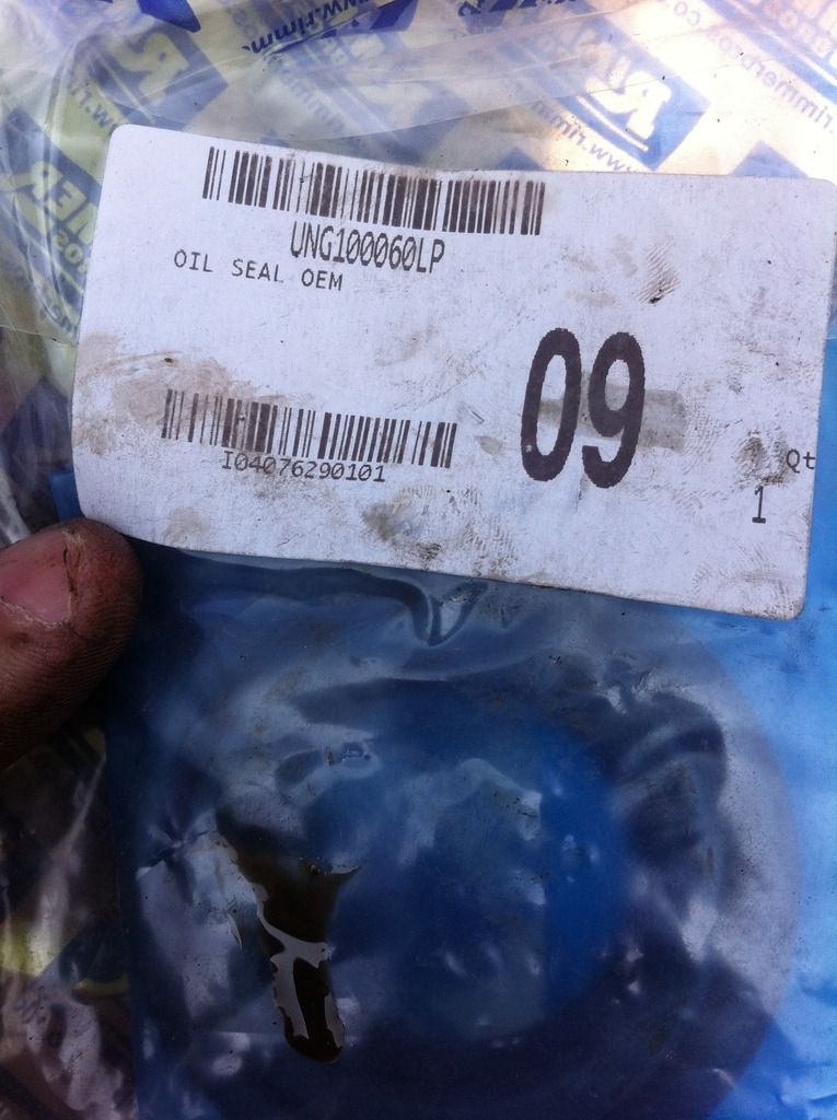

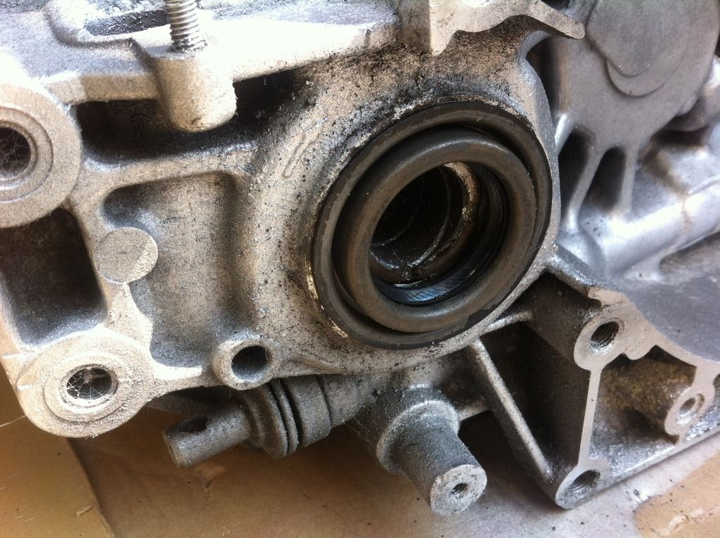

Genuine oil seals replaced on the gearbox after a little refurb of the second gearbox (long story).
One complete engine ready to fit.
and she's in, just a couple more mounts and we're good.
